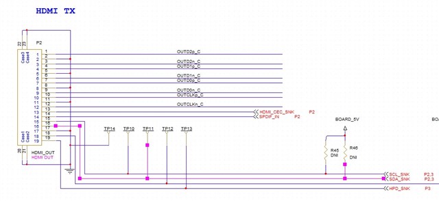

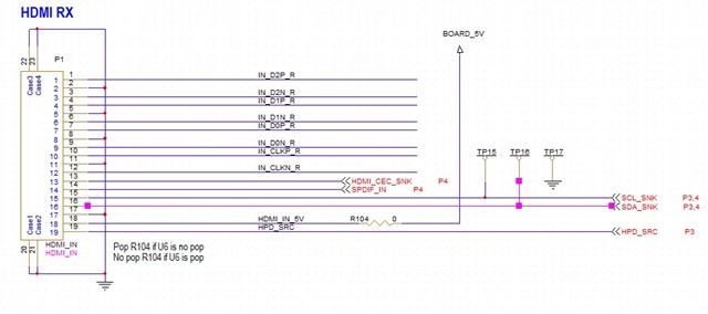

From the scheme it looks like SDA_SINK and SCL_SINK are connected to both HDMI TX and HDMI RX connectors.
In this way the TDP1204 DDC buffer will not come into play no matter which resistor is connected...
The LV_SCL_SRC and LV_SDA_SRC lines from TDP1204 are not going to either of the HDMI connectors.
Am I missing something?
Dan
  • Dan
    Your understanding is correct. Since the DDC bus is passing between the source and the sink, and both the source and the sink support 5V DDC signaling, then there is no need to use the TDP1204 DDC buffer. In this particular case, TDP1204 is snooping the DDC bus using its HV_DDC_SDA and HV_DDC_SCL.
    David
