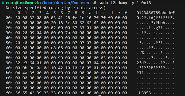

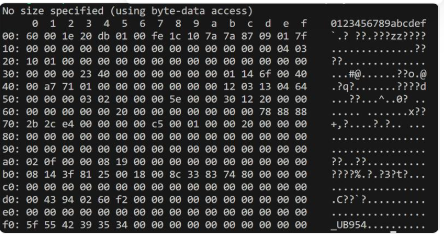

  • Thats correct we cant get anything from the V3 link just yet.
    Here is the register dump
  • Hi Austin,
    From the register map, LOCK is not set.
    We expect 954 reg 0x4D = 0x03 on a successful link.
    I see that 954 reg 0x58 = 0xDE, which means the BC is the correct frequency. Can you share the 953 register dump? And can you share the resistors used on the MODE pin of the 953 device? I want to make sure that the serializer is in the same MODE setting as the deserializer.
    Also, this is a small note. Can you make sure that 954 reg 0x58 = 0x5E?
    You don't want to set bits 7 and 6 at the same time. You only want to set one of them at a time, with the most common use case setting the I2C_PASS_THROUGH bit only.
    This is not a direct reason for the I2C issue. You mainly need to get LOCK established first.
    Justin Phan

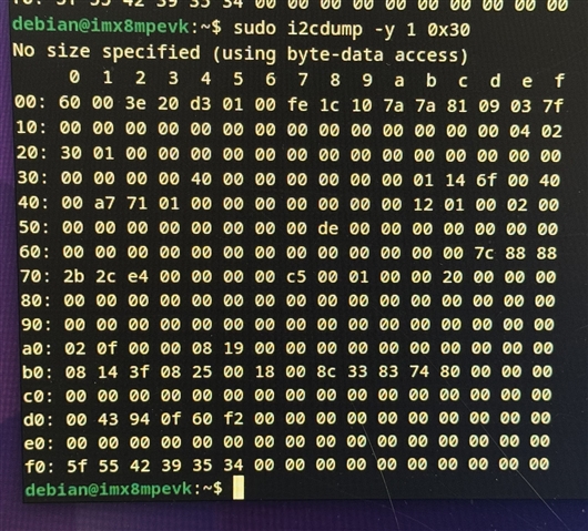

  • We did just change the 954 register as both 7 and 6 were set high.
    Here is the SER dump

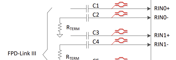

    There is no software setting to switch betwen STP or COAX mode. All that is required is a hardware change. You need to change the AC coupling capacitor on the RIN-/DOUT- trace to 15nF and add a 50-Ohms termination resistor at the RIN-/DOUT- trace.
    If you want to test COAX in your current hardware, you need to replace C2 with a 15nF capacitor. And find a way to terminate the RIN- line with a 50-Ohms resistor to GND.

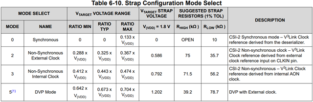

  • Hello Austin,
    If you are using the 954/953, then the 953 has these MODE options
    You typically want to use Synchronous or Non-Synchronous mode if you are connected to a 954. You only use DVP mode if the deserializer is a DVP deserializer, such as the 914A/934.
    For the 954, also keep it in either Synchronous or Non-Synchronous mode. Do not use DVP mode.
    Both the serializer and deserializer must be in the same MODE.
    Which type of errors are you getting on the 954 side? Can you clarify which MODE setting is on the serializer, the deserializer, and provide the reg dump of the 954 again?

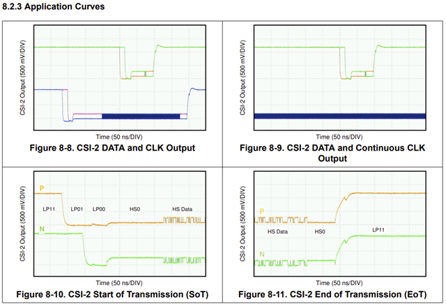

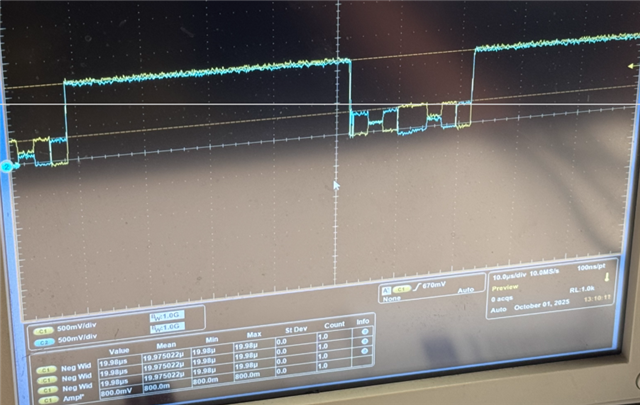

    Here is the MIPI into the SER
    Here is the V3 link data.
    But when I probe the DES the MIPI lines are just held high no data.
  • It looks like from the i2c dump the serializer has pretty much very error possible
  • Is the imager correctly programmed to output video data?
    The TDES954 is not receiving any video data.
    954 reg 0x 73 - 0x74 = 0x00
    954 reg 0x 75 - 0x76 = 0x00
    From your scope screenshots, it looks like maybe the high-speed video data is coming into the serializer, but I am not certain since the amplitude of the HS MIPI data is roughly 200mV and it is a little difficult to tell. But here is what I typically expect the output to look like.
    If the MIPI lines are held high at the DES, then definitely no video is coming out there.

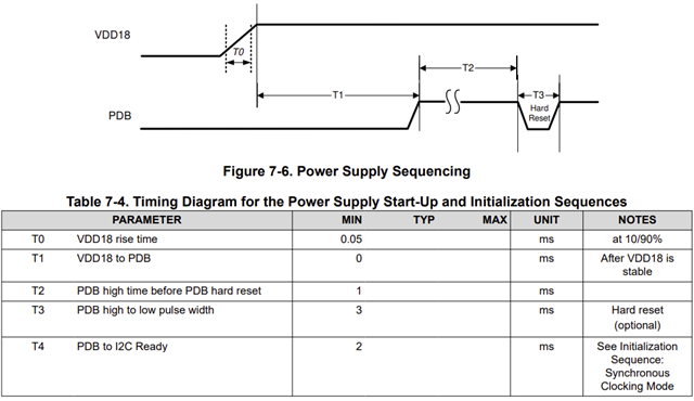

    Some things to check.
    1) Confirm if the imager has been programmed correctly.
    2) Confirm if all of the power rails to the 953 are at the expected values and that the Power-Up Sequence has been followed correctly.
    Make sure you are not sending any I2C commands until after at least 2ms after PDB is HIGH and after LOCK has been established.
    3) Can you confirm if you met 100-Ohms impedance control on the CSI traces between the image sensor and the 953 MIPI receiver? And if you correctly length matched the MIPI D-PHY traces?
    Justin Phan

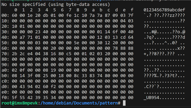

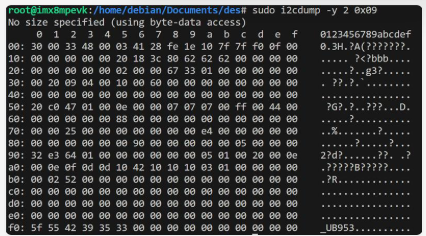

  • So we took the Imager out of the equation for now. When we do the random pattern generation from the Deserializer it looks very good.
    But then when we try to do the Random pattern generator for the Serializer we just get a bunch errors.
    Here is the DES i2c dump
    My impedance is 93 ohms on the Deserializer matched within 1 mil. and the Serializer is 99 ohms matched to one mil.
  • Also whats the expected voltage for LPF2 (pin12) on the Serializer? I was measure all the power pins and the 1.8V was ~1.75-1.8, and the 1.1 was 1.13-1.15, except LPF2 was 850mV.

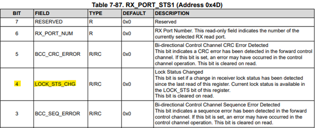

  • Hello Austin,
    If you read 954 reg 0x4D multiple times (maybe wait 1 second between each read), then does it always read out a value of 0x13?
    This register has multiple error flags that are cleared on read. I see that the flag for LOCK_STS_CHG is set.
    It might be set just due to power-up. But if you read 954 reg 0x4D multiple times and the error flag is not cleared, then that means that the deserializer is repeatedly losing LOCK with the serializer and you do not have a stable SerDes link.
    This means the high-speed channel between the SerDes is lossy and the SerDes devices cannot stably connect. This most likely goes back to how the differntial channel is 85-Ohms instead of 100-Ohms and this might be a design issue that requires a revision.

  • on power up it was 0x33, but after doing antoher dump it changed to 0x03.
  • If you read 954 reg 0x4D multiple times, do you always get a value of 0x03?
    Wait a second between each read and check if the value of 954 reg 0x4D updates.

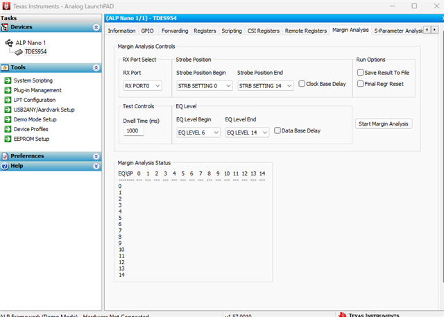

    Can you also run the MAP tool, to check the quality of the link? This can be done in the Margin Analysis tab in ALP
  • I dont have access to that since I dont have USB on my board. Is there a concern that PASS isnt working? Ive even tried BIST, and it locks but PASS stays low.
  • The concern is that you are getting unstable LOCK due to excess loss on the high-speed channel between the Ser and Des. By default, LOCK and PASS are linked together and they are both HIGH in the previous register dump. I am recommending 2 next steps.
    1) Read 954 reg 0x4D multiple times. Do you always get a value of 0x03? If you do not consistently get a value of 0x03, then that means LOCK is unstable because the error flag that LOCK is lost keeps getting set. If LOCK is lost, then you are intermittenly losing video data, which explains a lot of the errors you are seeing.
    2) If you cannot run MAP on your system, then you have to measure or simulate the Insertion Loss or Return Loss across your high-speed channel and make sure it is within the limits defined by TI.
  • We are getting 0x03 5 times in a row with about 10s in between.
  • Do you happen to have a UART to I2C converter tool, such as a USB2ANY or an Aardvark, which can connect an external lab PC to the local I2C bus of your system?
    It would help a lot if you can run the MAP program on a lab PC, since I assume right now, you are doing the software bring-up through an SoC.

       print("954 Device ID (0x00):", hex(board.ReadI2C(UB954, 0x00, 1)))  # Should be 0x7A
       time.sleep(0.5)
       print("953 Device ID (0x00):", hex(board.ReadI2C(UB953, 0x00, 1)))  # Should be 0x30

       print("Read BIST Lock Status Change of 954 RIGHT AFTER BIST enabled (0x4D):",
             hex(board.ReadI2C(UB954, 0x4D, 1)))
       print("Read to clear BIST enable Lock Status Change.")
       # Force 1 Error
       board.WriteI2C(UB954, 0xD0, 0x01)  # PORT_DEBUG register
       # Uncomment for continuous errors:
       board.WriteI2C(UB954, 0xD0, 0x02)
       time.sleep(10)
       # If forced continuous errors, stop forcing:
       board.WriteI2C(UB954, 0xD0, 0x00)
       print("Read Post-BIST Lock Status Change of 954 RIGHT BEFORE BIST disabled (0x4D):",
       print("Should read 0x03, If lock status changed during BIST, will read 0x13")
