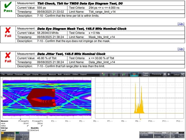

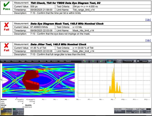

My customer use 1.7m cable to transmit HDMI (1080P 60fps) signal which tend some signal issue.
They would like to add TMDS181 as TMDS redriver.

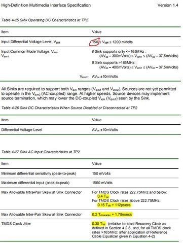

1.  The differential swing may not meet the protocol requirement of 150mV.
2. Eye diagram is not pass.
Could you help confirm that if the current signal quality meets the TMDS181 receive input threshold? and if the TMDS181 can recover the data completely and then output it. Thank you!
They test the currently eye diagram which looks like :
