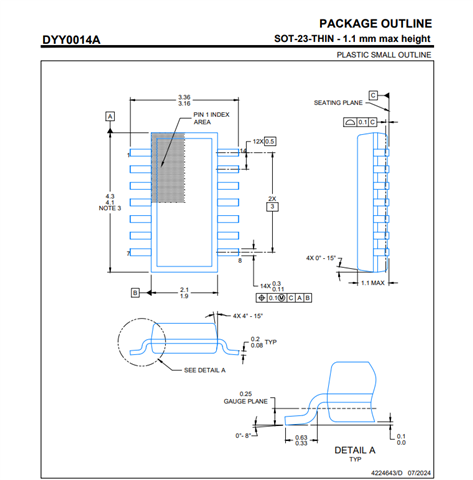

we need to conduct part authorization and hope to provide the Package Structure Diagram of TACN1145DYYRQ1

The package diagram can be found towards the end of the datasheet on pages 109 -111. Below is a screenshot for example:
