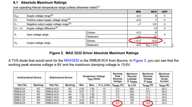

Hello team,
Based on the below article, SMBJ8.0CA is recommended for MAX3232. I don't understand this because abs rating is lower than Vrms. Can you explain why this part is recommended?
https://www.ti.com/lit/ta/sszt891/sszt891.pdf

    I'm not completely sure why that one was chosen it ultimately depends on the max peak current you're expecting. If the peak current is lower than 44.2A then the device will clamp earlier.

    So, if the customer chooses TVS diode, diode spec should have
    Vrwm > 5.2V(output of MAX3232)
    Vc < 13.2 (Abs rating of output pin)
    Is this correct?
    Austin
  • Vrwm > 5.2V(output of MAX3232)
    I think the working voltage should be larger than 6.5V since out device typical is probably closer to +/-5.5V
    And yes the max clamp voltage should target less than +/-13.2V. They will need to use a bi-directional TVS.
    I'm re-assigning this thread now.
  • Hi Austin,
    Yes, we recommend the clamping voltage of the diode to be at or less than the abs max of the IC needing protection. Since clamping voltage is a transient voltage and the transceiver abs max is a DC voltage, there is some wiggle room, but testing would be required to know for sure.
    In this case, I don't see a huge problem with using the SMBJ8CA but if you would prefer a smaller device then I can recommend our ESDS452 device.
