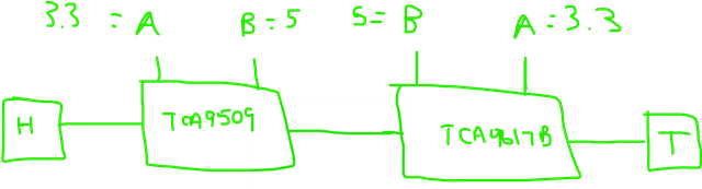

Hi Tyler,
customer plan to use 2 device as serial connection to expand the I2C communication distance. #1: 3.3V to 5V. #2: 5V to 3.3V. the VIL of target device at the end of cabling is 0.3*3.3V. The application is ventilation machine.
Rayna
Hi Rayna,
Due to voltage recommended operating conditions, the lower supply exists on A-side (VCCA) while higher voltage exists on B-side (VCCB).
In this orientation, this means you have TCA9617B, B-side connected to another B-side of a series TCA9617B. This is not allowed. See this application note for more details on static voltage offset: https://www.ti.com/lit/an/scpa054/scpa054.pdf?ts=1719932118796&ref_url=https%253A%252F%252Fwww.google.com%252F
I would recommend using TCA9509 connecting to TCA9617B.
See this app note for the reasoning why we want to connect TCA9509 B-side to TCA9617B B-side.
