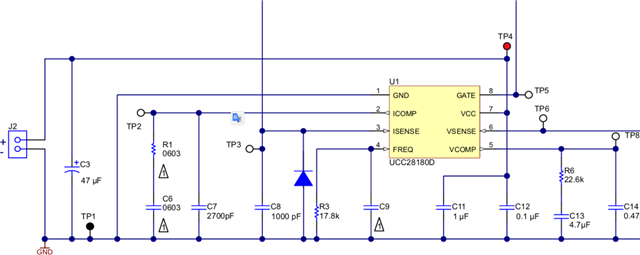

T-I製のUCC28180DRにつきまして問い合わせをお願いします。
データシートの推奨回路です。
ISENSE-GND間にダイオードが入っています。
・このダイオードの目的は何でしょうか?
・無いと何が懸念されますか?
・どんなダイオードを選定すればよろしいでしょうか?
・ダイオード選定する際の注意点は何でしょうか?

Please inquire about the UCC28180DR manufactured by Texas Instruments.
This is the recommended circuit from the datasheet.
A diode is included between ISENSE and GND.
・What is the purpose of this diode?
・What concerns arise if it is omitted?
・What type of diode should be selected?
・What are the points to note when selecting a diode?
  • Hi Yuka,
    • The diode is kept for the protection of ISENSE pin
    • If the diode is not there the inrush current might damage the ISENSE pin
    • You can use an ultrafast diode
    • The diode Vf should be greater than the maximum PCL threshold (–0.438 V) and less than –1.1 V across temperature and component variations
    You can look into this section of the datasheet to understand the reason better.
