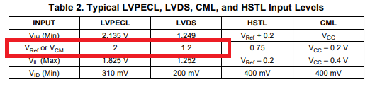

Hi Brian,
Thank you for this, this is helpful but the SN65LVEP11 component specifies in the datasheet that it can handle an LVDS input, so I was hoping to avoid converting to PECL. However the datasheet does not provide any more information on level requirements for an LVDS input. This is the information I was looking for.

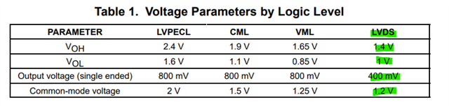

Hi Callum:
the common mode voltage between LVDS and LVPECL is different, you can not connect LVDS output directly to LVPPECL input.

Hi, Yes this makes sense, however the datasheet for this part states that it is LVDS input compatible in the features list. With this being the case is there levels defined for this part to ensure we are meeting them with an lvds signal?
If the LVDS signal is 400mv single ended with 1.2v CM, high voltage is 1.450v and low voltage is 0.95V. For LVPECL , 1.45v can not meet min Vih voltage 2.135V.

If the VCC of the SN65lvep11 component is set to 2.5V we would be meeting the VIH and VIL with a 1.2V CM LVDS signal though correct?
Hi Callum,
We can see that even if the common mode can be set to the same level the swing levels will not be 1:1 compatible. Please use the input circuitry to implement LVDS in this part. Otherwise this application will not work as expected.
