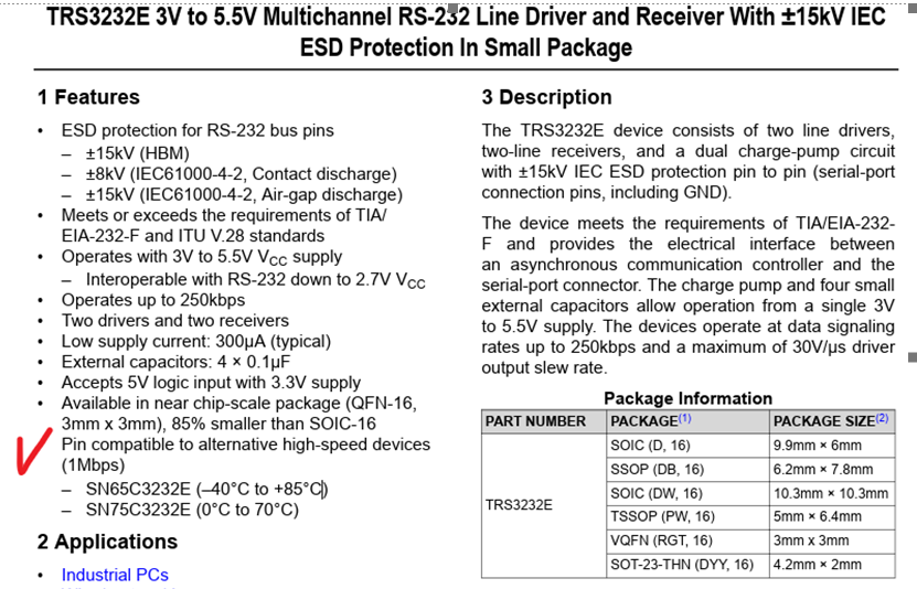

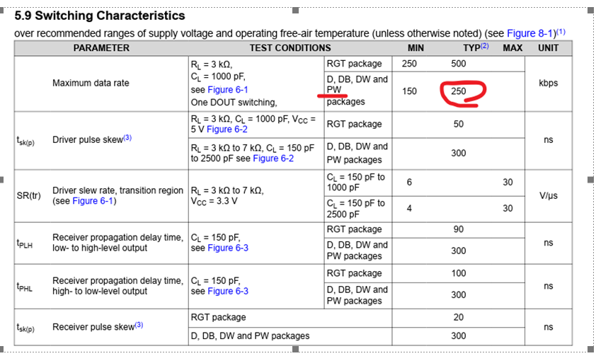

Part Number: TRS3232E
Hi SIR
I saw the TRS3232E datasheet and on the same package the data rate only 250 kbps.
Can the data rate really reach 1Mbps? or Just pin compatible.
