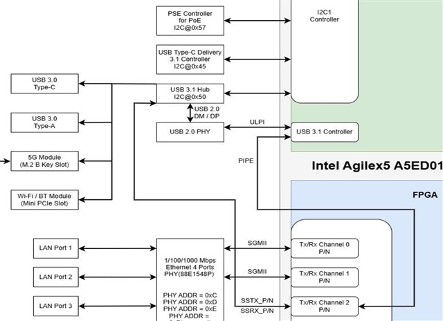

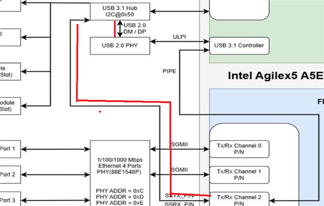

TUSB8044: TUSB8044 active reset: Hub cannot recognized by my SoC
Part Number: TUSB8044
Hi Sir,
We are using TUSB8044 hub upstream port to connect to my SoC USB3.1 controller transceiver.
  1. But when we did manual reset GRSTz (active reset), our SoC just cannot find the hub (the power seq is correct VDD33 is stable before VDD11).
  2. On the contrary, when we used passive reset GRSTz (4.7uF), we have 30% possibility to find the hub even though the power up sequence is incorrect (VDD33 leads VDD11).
  3. When we use passive reset and corrected power sequence, our SoC just cannot find the hub (the power seq is correct VDD11 is stable before VDD33)
Could you please advise what method or I2C register we can check whether the hub boots up correctly?
Attached is block diagram for your review.
