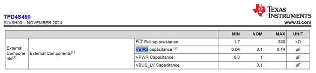

According to the specs, VBIAS suggest a 0.1U 100V capacitor.

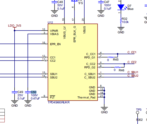

However, according to the reference circuit slvucp8 in the attached file,
is VBIAS C50 a 0.47U 100V capacitor?
