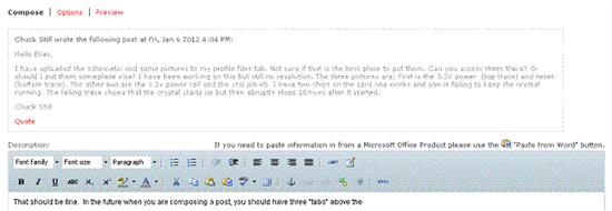

  • Hello Elias,
    I have uploaded the schematic and some pictures to my profile files tab. Not sure if that is the best place to put them. Can you access them there? Or should I put them someplace else? I have been working on this but still no resolution. The three pictures are; First is the 3.3V power  (top trace) and reset (bottom trace). The other two are the 3.3v power rail and the xtal pin 45. I have two chips on the card one works and one is failing to keep the crystal running. The failing trace shows that the crystal starts up but then abruptly stops 16msec after it started.
    Chuck Still
  • Chuck,
    We can access the files there.
    In the future when you are composing a post, you should have three "tabs" (Compose  |  Options  |  Preview) above the post you are replying to:
    This is not that intuitive, but if you click on the "Options" tab, you should be able to attach files to a specific thread.
