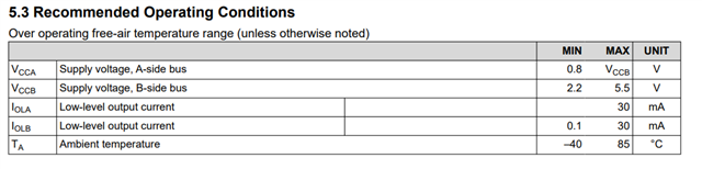

Could both VCCA and VCCB of TCA9617B and TCA9517B be 3.3V? Which means VCCA equal to VCCB. Thank you.
