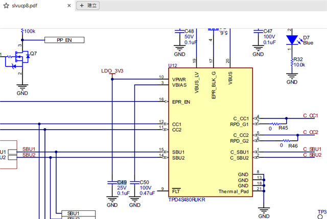

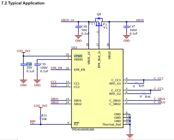

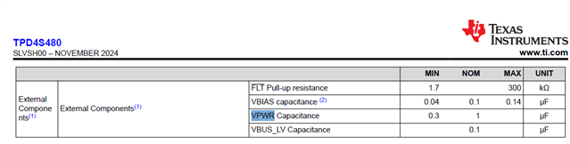

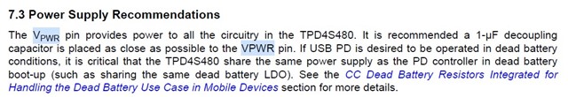

Hi
What is the suggest VPWR Capacitance value? Cause Reference Design and Datasheet is difference.
