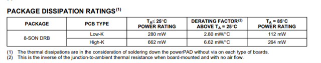

I understand from the datasheet that the device is characterised for operation up to +85degC. I suppose this is the ambient air temperature.
I would like to check if a maximum operating junction temperature is available?
Thank you

    So it isn't directly spec'd but you can derive it to be 125C.
    From this table we can derive R_theta_JA - which is the thermal ambient to junction impedance.
    There are two values here - one for a Low-K and one for a high-K PCB.
    If you take the inverse of the derating factor above TA = 25C  - that is the R_theta_JA value.
    So for Low-K R_theta_JA = 357.14 C/W
    For High-K R_theta_JA = 151.06 C/W
    We also know that:
    TJ = TA + P*R_theta_JA
    and we are also given power ratings
    If we plug in the max ambient temperature allowed + the max power dissipation of IC from chart we can get the max TJ - or the max junction temperature.
    So
    High K PCB --> TJ = 85 + 112mW * 357.14 = 125C
    Low K PCB --> TJ = 85 + 264mW * 151.06 = 125C
    So since our max power ratings and the thermal to ambient junction impedance are spec'd we can derive max allowable junction temperature to 125C for this device.
