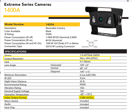

Will the TVP5150AM1 work with this camera? NTSC at 966x494 resolution.

If you mean to take the NTSC output (e.g. composite video) from the camera and feed them to the TVP5150AM1 for decoding then I think it will work.
