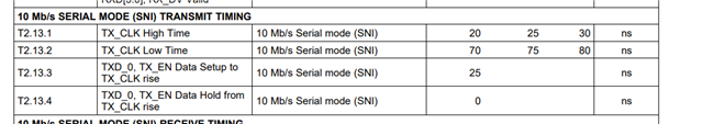

Q1: At SNI mode, how much is RXD[0] to RX_CLK setup time and hold time respectively?
Q2: At SNI mode, how much is TXD[0] to TX_CLK setup time and hold time respectively?

    Q1: There is no setup/hold time since this is driven by the PHY. Please follow the MAC's setup/hold time. This is driven synchronously to the RX_CLK recovered from the CLK.
    Q2:
