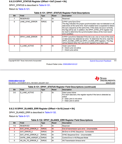

1.Circuit Configuration: Serializer uses the DS90UB941ASRTDTQ1. Deserializer uses the DS90UB948TNKDRQ1.
2.Problem Description: After powering on, the problem described in the video may occur. After the problem occurs on the first power-up, it persists until the power is cycled.The problem does not occur on the first power-up, and it remains until the power is cycled.
  • In addition, when a fault occurs, the value of the dphy register 0xf is 0x3f, and the values ​​of the dlane registers 0x10-0x13 are all 0x10

    Reply:
    1. Our register configuration is as shown in the diagram below.
    2. This fault also occurs when switching from the currently set continuous clock mode to discontinuous mode.
    Register readback value:
    DSI_SYNC_STATUS 0x15 0x00
    DSI_STATUS 0x28 0x05
    DSI_ERR_COUNT 0x29 0xff
    Tried:
    Soft reset: Set main page 0x1 register to 0x01 for reset. Symptoms occur intermittently with no improvement.
    DSI register 0x21 DSI_NO_EOTPKT = 1: According to register definition, this only disables error alerts. Not attempted.
    Tried varying DSI clocking mode (Main Page 0x4F[7] and 0x56[1:0]):
    The fault also occurs when 0x4F is set to discontinuous mode alone. Setting 0x56 to any mode other than DSI reference clock mode prevents normal display.
