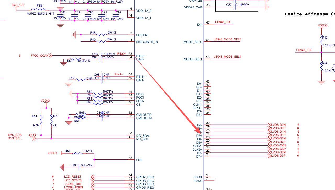

Please explain in detail how to configure this mode. Thank you!

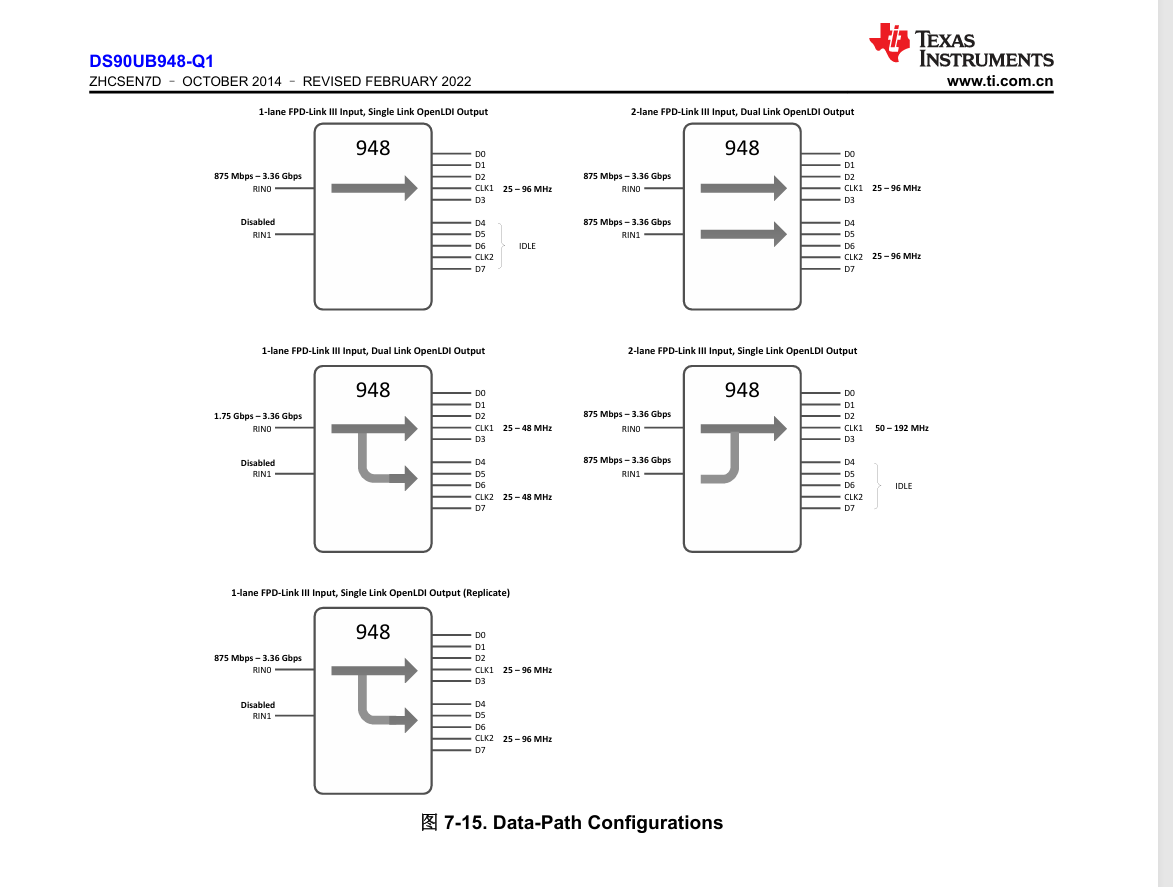

  • Hi Tony,
    This should be possible with OLDI Port 1 and Port 0 active to achieve the diagram you have shown where RIN0 > D4-D7.
    The replicate feature should be employed here, as the content coming into RIN0 will be replicated at both Port 0 (unused) and Port 1.
    Depending on the MAPSEL you will need for the timing configuration, this will either be No. 3 or No. 7.
    Reminder of MAP_SEL modes are shown below:
    Please let me know if you have any questions!
    Miguel
  • hi Miguel Bolante
    There is no LVDS signal output now,Register configuration is 0x34=0x03,0x49=0xe3。
  • Hi Liguo,
    Register 0x34 refers to the RX mode on the 948. Is there a serializer sending video through the FPD-Link at this time?

    For register 0x49:
    7 = MAPSEL = H
    6 = MAPSEL overwrite enabled
    5 = MAPSEL overwrite = H
    4-2 = Reserved
    1-0 = Replicate FPD-OLDI Output
    From the register configuration of 0x49 = 0xE3, I am assuming MAPSEL = H is chosen, does this match the application of the LVDS display?
