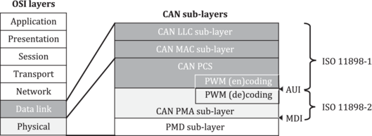

    1.Does the TCAN1043HG-Q1 comply with ISO11898-1 standard?
    -Zhao
  • Hi Zhao,
    Glad that helped.
    ISO 11898-1 is the standard for the data link layer and physical coding sub-layer. This is intended to standardize the microcontroller, not the transceiver. TCAN1043 (which is a transceiver) is only standardized by ISO 11898-2.
    Ethan
  • For more information, please consult the ISO website: https://www.iso.org/obp/ui/#iso:std:iso:11898:-1:ed-3:v1:en
