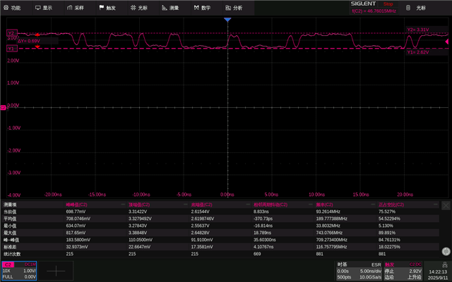

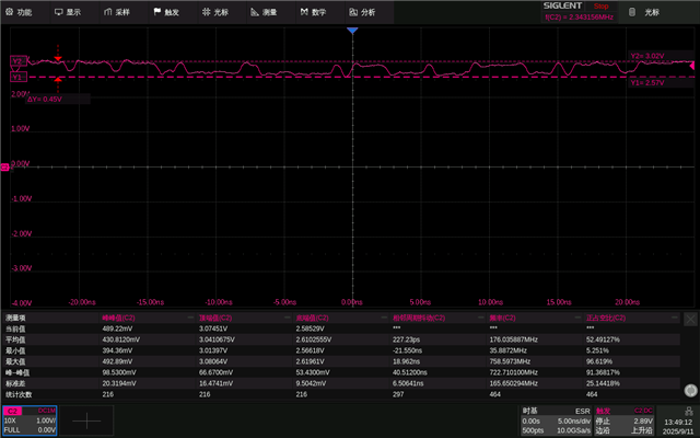

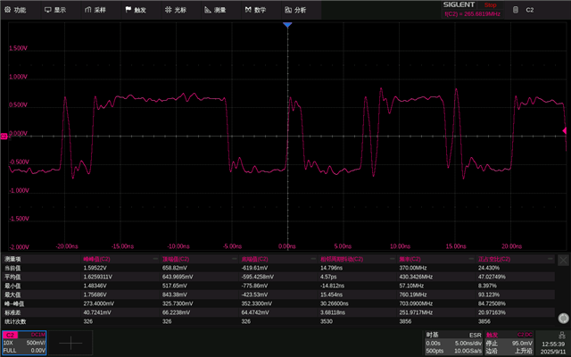

1. The issue description: in our application, we have two DVI(HDMI1.4) outputs using two SN65DP159RSB retimer. the schematic design is exactly same and the PCB layout is basically same and adjcent placed. Hereinafter referred to as DVI1 and DVI2. Basically the DVI1 and DVI2 were operated same time, after one period normal operation,  the DVI1 output abnormal(no display on some or most monitors) while DVI2 still good. Among a total of about 20 products, 4 cases were found.
2. The debugging I have did
 i. Compare the DVI1 and DVI2, the inputs signals are same but the outputs of DVI1 are abnormal, as screenshots as below
DVI2 outputs (OUPUT_D2), differential signals, normal
DVI2 outputs (OUPUT_D2_P), single mode signals, the OUTPUT_D2_N is similar

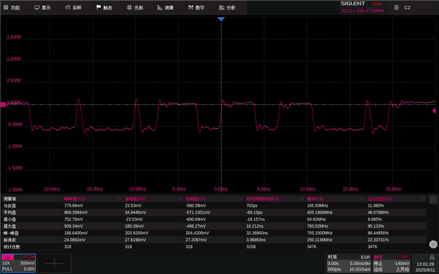

DVI1 outputs (OUPUT_D2), differential signals, abnormal
DVI1 outputs (OUPUT_D2_P), single mode signals, the OUTPUT_D2_N is similar

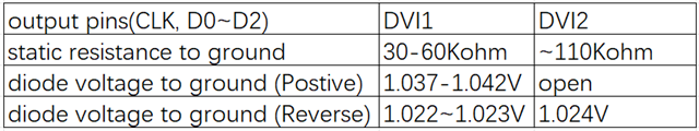

ii. Compare the DVI1 and DVI2, the static measurements as below
iii. Rework to replace the DVI1's retimers chip bty new one, the output signals are normal and the monitor display ok.

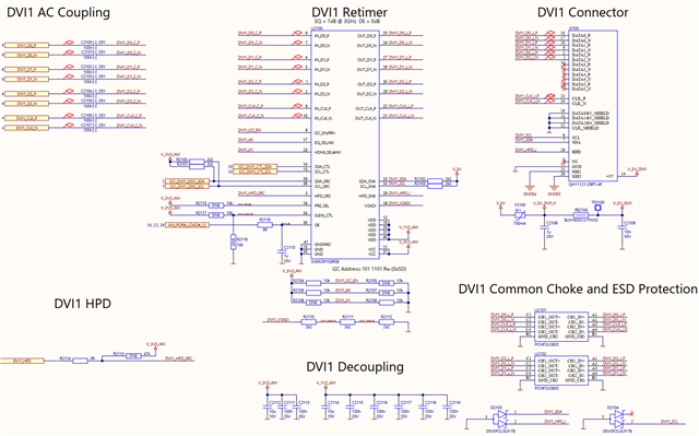

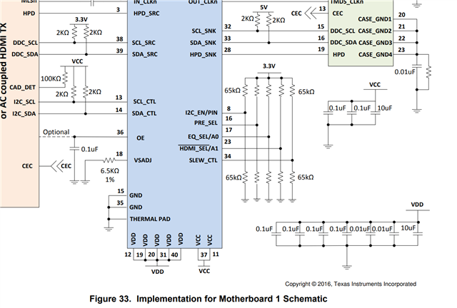

4. design inputs for review
i. Firmware: I2C config but completely default settings
ii. Schematic

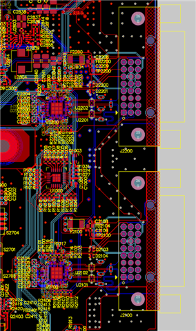

iii. Layout
    1. For I2C_EN, PRE_SEL, EQ_SEL/A0, A1, SLEW_CTL, you have to use 65k pullup/pulldown resistor for the DP159 to correctly sample these pins as shown below.
    2. You have three set of resistors for VSADJ, is it possible to use only one resistor and make sure the resistor tolerance is +/-1%?

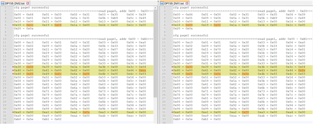

    3. Since you are using I2C register to configure DP159, is it possible to dump out the DP159 register between DVI1 and DVI2?
    4. Does the DVI source support AC coupling?
    5. Any chance you can share the actual layout instead the screen capture?

  • Hi David,
    Sorry for the late reply.
    Regarding 1 and 2, I will consider these improvements when next design change.
    3. see below.
    DVI1 Abnormal Port
    cfg page0 successful
    ------------------------------------------------read page0, addr 0x00 ~ 0x20------------------------------------------------
    0x00 = 0x44     0x01 = 0x50     0x02 = 0x31     0x03 = 0x35     0x04 = 0x39     0x05 = 0x20     0x06 = 0x20     0x07 = 0x20
    0x08 = 0x01     0x09 = 0x06     0x0a = 0x31     0x0b = 0xb9     0x0c = 0x49     0x0d = 0x14     0x0e = 0x00     0x0f = 0x0f
    0x10 = 0x00     0x11 = 0x00     0x12 = 0x00     0x13 = 0x00     0x14 = 0x00     0x15 = 0x80     0x16 = 0x00     0x17 = 0xf0
    0x18 = 0x00     0x19 = 0x00     0x1a = 0x00     0x1b = 0x00     0x1c = 0x00     0x1d = 0x00     0x1e = 0x00     0x1f = 0x00
    0x20 = 0x0a

    4. yes, the DVI  is FPGA SOC, with HDMI Driver module.
    5. the whole design is really huge, maybe i will share with you by suitable time.
    Looking at the register dump, both DP159 are able to detect the correct input clock frequency and goes into the re-timer mode, so I don't see an issue with the inputs.
    If you replace the DVI1's retimers chip by a new one, and the output signals are normal and the monitor display ok. Can you put the bad DVI1 on a working board and is the output signal normal?
    David
  • Hi David,
    1.I will share the result to you once i completed the testing. Now, i suspect it's EOS demage and try to do ESD and hot-plug testing to reproduce the fault.
    2. May you sugesst the PU/PD setting for those IOs under I2C working mode? leave them floting?
    3. May you share the registers' setting example of HDMI AC coupling input and DVI output?
    In I2C mode,
    I2C_EN: 0 - 65 k (± 10%) pullup resistor to 3.3 V for I2C mode
    EQ_SEL/A0, HDMI_SEL/A1: e, 65 k (± 10%) pullup to 3.3 V, or 0 - 65 k (± 10%) pulldown to GND to set DP159 I2C address
    SCL_CTL, SDA_CTL: I2C clock and data signal
    SLEW_CTL, PRE_SEL: Floating
    The register default setting will support HDMI AC coupled input and DVI output.
    On a bad DVI1, if you remove the external ESD protection diode, do you see a change in the output amplitude?
    David
