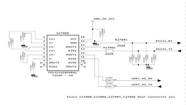

In one of our ADAS projects, we are using the TRS3232EQPWRQ1 (Automotive grade) to support R323 communication protocol.
I have a few queries regarding protection in case of a short-circuit scenario:
We are considering a test condition where the RIN1 and DOUT1 pins may be exposed to a 32V short-to-battery situation.
Currently, we have placed 499Ω resistors (0402, 0.1%) in series with both RIN1 and DOUT1.
Could you please confirm:
  1. Are these resistors sufficient to protect the IC under a 32V short-to-battery condition?
  2. What would be the expected behavior of the IC if this short occurs?
    • Will the internal protection of TRS3232EQPWRQ1 handle this?
    • Is there a risk of permanent damage or degradation?
  3. If the resistors are not sufficient, would you recommend adding a series TVS diode at the connector interface?
    • If yes, could you suggest suitable TVS diode specifications?
Your guidance will help us ensure robust protection and compliance with automotive standards.
Above the schematic image for your reference.
