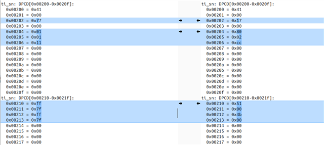

I also read the DPCD of the sink and compared the passing and failing cycles.
According to the DP standard, registers 0x103 and 0x104 set the output voltage and pre-emphasis levels respectively. In a failing cycle, these registers are set to the value `0x30`, which indicates a pre-emphasis level of 2 and that the maximum setting has been reached. This is the same as I could read out before from the bridge.
Left Pass, Righ Fail
Looking further, if it's a pass, I see register 0x202 has a value of 0x77, so CR and channel EQ have been completed and the symbol is locked for lanes 0 and 1.
However, if it fails, the value is `0x17`, meaning that the CR and channel EQ are complete and symbol is locked for lane 0 but lane 1 has the CR complete, but the channel EQ fails.
Registering a value of 0x00 instead of 0x01 in register 0x204 also shows me that interlane alignment was not successful.

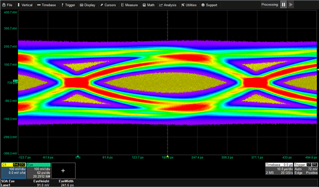

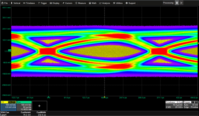

This all would point to a signal integrity issue in the main link, probably on lane 1, but looking at lane 0 and 1 the eye seems to be good enough. The measurement was done directly on the eDP connector.
channel 0:
channel 1:
