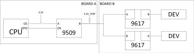

  • Hi Tyler,
    Pls refer to the block diagram below. The I2C on the CPU side is powered by 3.3V, but the other devices are powered by 3.3V STBY. So basically, I need a device to isolate the 2 different power domains to avoid leakage. The problem is that the 9617s are on other boards that are already in production, and there are two different configuration.  The B side of TCA9509 would be connected to both A side or B side of TCA9617. Could you please check if this application is ok? If not, is there a replacement for 9509?
    Rregards,
    Hailiang
  • Hi Hailiang,
    This is a valid connection. Either the TCA9509 can be connected with A-side facing CPU with no pull-up resistors and B-side facing 9617B's.
    Or you can replace TCA9509DGKR with p2p TCA9617B with A-side facing the other 9617B's, and B-side facing the CPU side. However, VIL(cpu) = 0.3 x 3.3 = 0.99V for this to work. VOLB of the TCA9617B will not work for the CPU if its VIL = 0.4V.

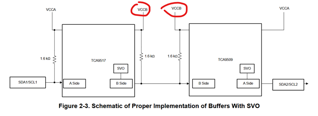

  • Hi Tyler,
    There's one more question. In the doc you sent (slvafn4), the nets between 9517 B side and 9509 B side have two PUs to VCCB. But actually, the two VCCB can be two different power rails, right? And if they are the same power rail, just one PU is needed? Thank you.
    Hailiang
  • Hi Hailiang,
    You don't have to have two 1.6kohm pull-up resistors to VCCB. Only one pull-up resistor is fine.
    In figure 2-3, VCCB should be the same for TCA9517 and TCA9509. Not two different power rails.
