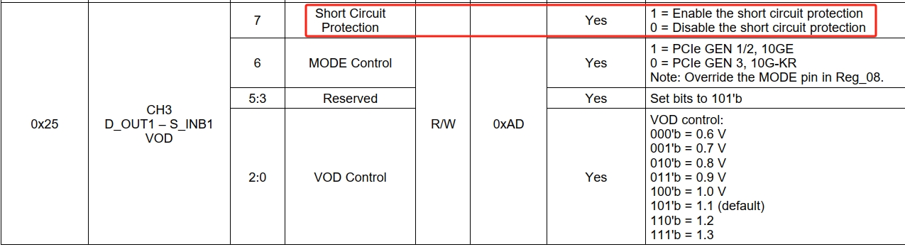

Dear Team,
In DS125MB203, I see an Enable or Disable setting for each channel short circuit protection.
I'm curious about when it's necessary to enable or disable this register setting. I think maybe enabling short circuit protection should always be needed.
By the way, what is the relationship between the above short circuit protection with the below info inDS125MB203 datasheet.
If the short circuit protection is enabled, the short current will be limited to 20mA?
