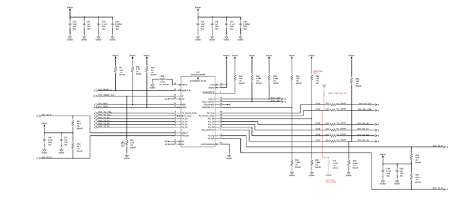

Hi, I am trying to interface PHY Dp83822H with FPGA. I am able to write and read PHY registers. It is configured for RMII, 100mbps, full duplex mode.
I am sending TX[1:0] and TEN signals to PHY from FPGA (Not using MAC). It is a generic Ethernet frame with UDP payload. Everything seems correct but I am not able to see anything on the wireshark. No transmit data is coming out of PHY.dp83822h_settings.xlsx
    Register 0x0001 shows that there is no link. If there is no link, the PHY will not be sending packets out.

    Could you share us your schematic so we can check if there's any connection error? Can you receive packets without any issues?
    Please feel free to message me your schematic. I've sent you a friendship request.

    Thanks for the reply. Here is the schematic.

    Below are the comments on the schematic:
    1. It looks like signal connections were meant for MII, not RMII. Is pin 1 connected to the MAC's clock pin?
    2. The PHY has internal termination so it does not need 33ohm resistors in the RX line.
    If pin 1 is not connected to the MAC's clock pin and the MAC is driving the 25MHz clock into the PHY, I will recommend to put the PHY in RMII follower mode and input 50MHz clock into the PHY to make RMII work. Otherwise, RMII will not work in the current design.

    3. I am receiving 50MHz clock form PHY on pin 1 (RX_D3). I am using this clock to generate ethernet frame and sending it to the TX [1:0] pins, with TX_EN. The transmit data is changing at the falling edge of this 50MHz clock.
