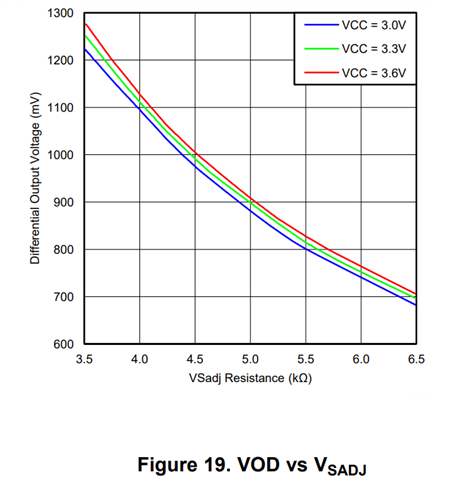

SN75DP139: lower resistance value on VSADJ
Part Number: SN75DP139
The datasheet specifies a 4.02kΩ resistor. In our testing, we found that must using a 3kΩ resistorpass our signal integrity (SI) tests.
We'd like to understand the potential risks of using a lower resistance value that our tests might not be capturing.
