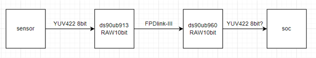

we used your serial deserialiser solution for getting data from the camera, the data flow is as follows:
sensor(x4) --> DS90UB913(x4) --> DS90UB960
sensor format :For details, please refer to the content of the picture.
Please provide the configuration file of the deserialiser DS90UB960 and serialiser DS90UB913 for reference, thank you!
Best Regards
    Thank you for reaching out. As long as the hardware mode pins are configured correctly, these devices will lock automatically. After locking, only a few registers will need to be programmed on the 960 for video streaming.
    Set register 0x70 = 0x1E to program YUV422 8-bit
    Set register 0x7C[7:6] based on the desired system configuration (upper or lower 8 bit processing)
    Some sensors will use a serializer GPIO pin to toggle a sensor reset pin. If this is necessary for this sensor, registers 0x0D or 0x0E based on the which GPIO pin will be connected to the sensor.
