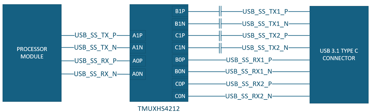

we need to make USB superspeed lane switching on the USB-C connector according to cable orientation. Can you confirm that the AC cap locations in the below image are correct? The caps are 100nF/0402.

Hi Juha,
Yes the location of the AC capacitors are correct. The 100nF caps are fine, they are within the range of 75 - 220nF.

Hi Juha,
If you look at the typical application section of the data sheet, it will also show how to implement this device.
