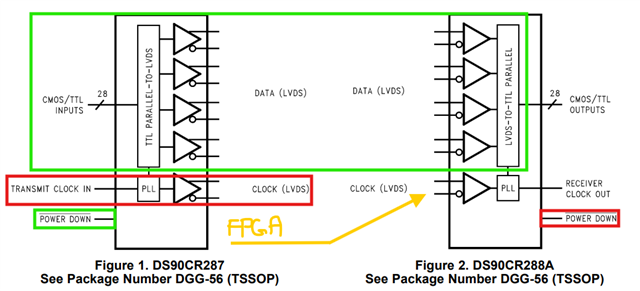

Hi everyone,
I have DS90CR287 for TX and DS90CR288A for RX chips. I tested before these chips (first power up) and i get clock and data with little noise. Design has decoupling capacitor. Then second power up i can not get any clock from TX side. I give diff clock with FPGA to RX chip, it is worked. Problem is TX side. My boot up sequence is below:
  1. TX power up ( PWRDWN is low)
  2. FPGA power up and give clock same time.
  3. TX PWRDWN is high.
So reference guide and other thread what i read , telling me this seqeuence. But i can not get any clock second power up section. Is it about chip or PLL? All voltages is 3.3 and ground is connected. (PLL,LVDS and VCC ext.) I changed IC 3 times and same results i get.
Thanks for reply.

  • Hi Miguel,
    First i tried this, there is no RX connection.
    1- FPGA no power up, bitstream is ready with clk. When i power up, it will be out from pins to TX pin. TX has no power this time.
    2- TX is power up but PWR_DWN(32. Pin) is thorugh to GND (pull down). Chip has 3.3V each VCC, PLL_VCC and LVDS_VCC pin. (I make toggle different time same scenerio btw)
    3- Then TX_PWR_DWN is going to HIGH. (pull-up). Chip has TX CLK_IN but there is no CLK_OUT.
    Same scenerio, with RX connection, when i TX_PWR_DWN is pull up, RX chip is PWR_DWN pulldown but has power. Then i pull up RX_PWR_DWN. I tried all scenerio i guess. RX and TX has same GND and VCC source btw.

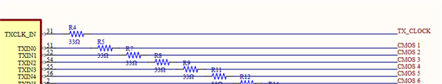

  • Hi Miguel,
    I found something but i want to ask you, in reference design, all lines has trace resistor and connected to ground.
    In our design is like this:
    There is no any ground before the pin or trace. Could this have an impact? I can not found anything.
  • Hi Samet,
    This reference design is taking into account that the inputs may be terminated differently.
    I do not think your configuration shows any issue.

  • Hi Miguel,
    I found the problem. Footprint was wrong. It could be about snapeda or something i dont know exactly. 25th (TXIN23) and 26th(VCC) pins was swapped.  We made some modification and problem was solved.
    Thanks for all helping.
