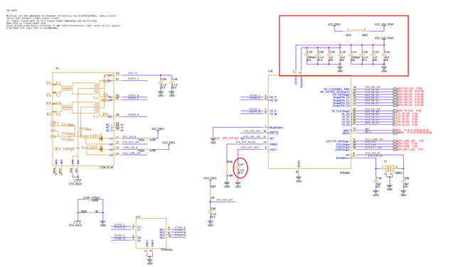

We are designing an Ethernet switch where the DP83826 is implemented as the Ethernet PHY for the upstream interface. During the circuit design, we have a couple of doubts that need clarification:
  1. Should the CEXT pin be connected to a 2 nF capacitor, as specified in the datasheet?
  2. Please review the attached schematics. Should we strictly follow the power-up sequencing as mentioned in the datasheet?
Your guidance on these points will help us proceed with the design confidently.
  • Hi Jefin,
    Yes, it should be connected to 2nF capacitor.
    Yes, we recommend to strictly follow the power-up sequencing of possible.
    Are the MDI lines meant to be connected to the NC pins of the ESD diode?
