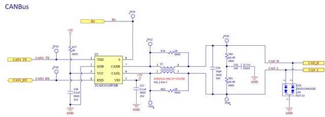

Hi
Please help review schematics, thanks!

Hi Kevin,
The schematic looks okay overall. I would recommend to depopulate C36 and may use bus caps as needed, but after the termination. Include similar to figure 11-1 of the data sheet example. Please promote ESD2CAN24-Q1 for CAN applications, thanks.
Michael.
