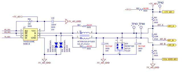

THVD1520: THVD1520DR schematics review
Part Number: THVD1520
Hi
Please help review schematics, thanks!
  • Hi Kevin,
    Everything looks good from what I can see.
    Only suggestion is to move the ESD diodes D30 and D31 closer to the connector to get more out of them. (From a PCB point of view they should be as close to the connector where someone could potentially touch it).
    -Bobby
