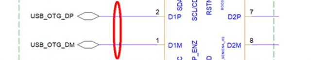

Dear TI experts,
My customer made their schematic using TUSB216. Could you review this schematic?
Chase

Hi Chase,
Please ensure the DP/DM lanes are connected beneath the redriver.
For BOOST and RX_SEN, we recommend starting at boost level 0 or 1 and RX_SEN level medium. Currently it is set to BOOST level 2 RX_SEN high. Additionally, please ensure the voltage divider for RX_SEN is set so the correct voltage reaches the RX_SEN pin:
Otherwise, I don't have any other notes.
Ryan
