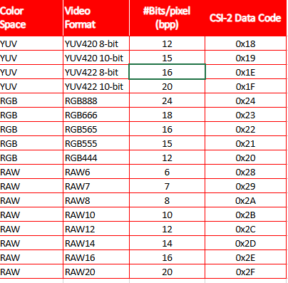

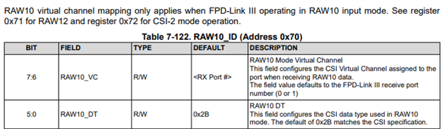

The 936 is compatible with the 933. the 936 can be programmed to convert the parallel video data into CSI packets. Please make sure the correct RAW10/12 bit mode is used and that you desired data type is a multiple of 8/10/12 accordingly. So that the 936 can properly convert the parallel data to CSI packets.

The 936 uses the PCLK, HSync, VSync, and parallel data from the 933 to generate CSI-2 data packets. Here are examples of some of the CSI packets that can be packaged into.
Please note that not all formats are supported, since the parallel data needs to fit into the 8/10/12 parallel lines on the 933.
The 936 needs to be programmed to package the parallel data into the desired format, to prevent data corruption.
