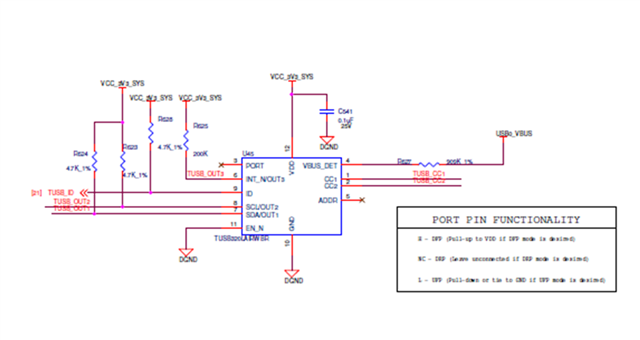

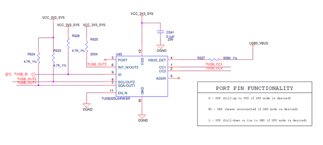

Hi Experts,
We have used TUSB320LAI in our design to support DRP mode.
The intention of using it is to switch between UFP & DFP based on the external attached device mode.
But, it is not happening as expected, the ID pin stays high (due to external pullup) irrespective of external USB device mode.
The Schematic image is attached below for your reference.
Please advise us, why the ID pin stays idle(high) even with external DFP(host) connectivity?
  • Hi Dharani,
    For the ID pin, we recommend a 200KOhm pull-up, as a weaker pull-up will ensure that the ID pin pulls down properly.
    When connected to a DFP, the TUSB320 will configure as a UFP. The ID pin is not used when the TUSB320 configures as a UFP, and is only used when the TUSB320 configures as a DFP.
    Can you monitor the CC pins when you expect the ID pin to be low, to ensure the CC lines are connecting as expected? You can also try forcing the PORT pin to DFP mode to ensure it configures as intended.

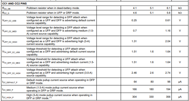

    Is it possible to monitor the CC pins before and after a connection is made when in I2C mode? If the device is set to DFP mode, the CC pins should be pulled-up when there is nothing connected, and then pulled down to the specified voltage below for default current-advertisement:

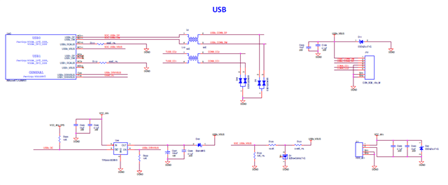

    I am attaching the CC controller schematics section along with load switch for your reference.
    Please check and advice us

    One recommendation I have, looking at the CC pins, would be to remove the CMC choke and ESD diodes from the path of the CC pins, and directly connecting the CC pins of the type-C connector to the TUSB320. Also, what is the clamping voltage of these ESD diodes? Typically, we recommend directly connecting the CC pins of the controller to the connector, with no components between.

  • Hi Ryan,
    Thanks for the timely reply.
    Sure, We will bypass the CMC & isolate ESD on CC lines & we will monitor the CC Lines.
    We will also update you on the signal behavior on the DFP Mode.
    The clamping voltage of ESD diode is 6.4V(with IPP - 1A) & 8.4V(with IPP - 5A)

  • Hi Ryan,
    Thanks for your constant support.
    After bypassing CMC & isolating the ESD on CC lines.
    We observed the below things on the CC Lines& ID pins toggles based on external connectivity.
