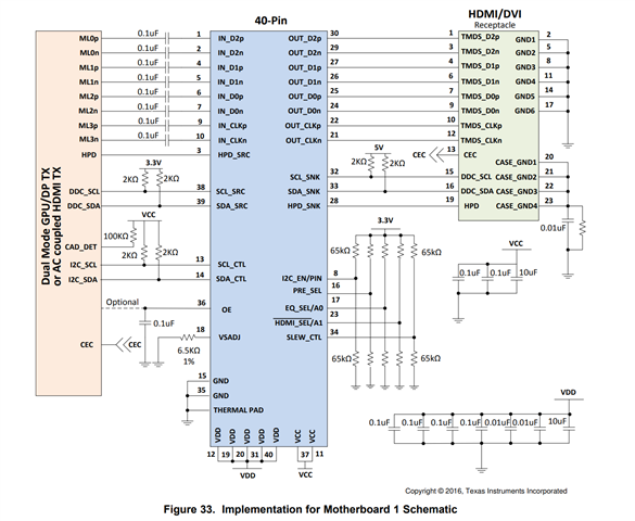

    There's one more thing that has me really confused. The DP differential pair signals are AC-coupled, but HDMI's TMDS is DC-coupled. If I'm not mistaken, converting DP to HDMI requires an AC-coupling combined with a level-shifting circuit that includes a 499-ohm resistor to ground. However, in the DP++ circuit, I only see AC-coupling capacitors. So, from a hardware perspective, how does DP++ meet the transmission requirements for both DP and HDMI signals? Does the passive DP-to-HDMI adapter already include a circuit with a 499-ohm resistor to ground?

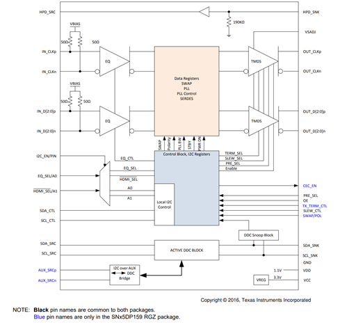

    Your understanding is correct. DP159 is a DP++ to HDMI level shifter as an example. Below is its implementation block diagram. You can see its input is AC coupled to a DP++ source, and output is DC coupled to a HDMI receptacle.
    And its input has internal 50ohm to VBIAS, which in this case, is 0.7V.
