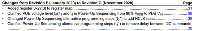

    The difference between the revisions is documented in the Revision History located in section 4 of the datasheet as pictured below:
    The change clarifies the power sequencing diagram that the voltage level threshold is PDB VIH rather than 90% of VPDB. Secondly, the local I2C workaround was updated to include an NCLK reset as the first step to the workaround if the t3 timing constraint is not met.

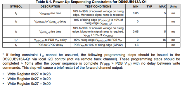

    The power-up sequencing diagram was updated with Vdd_n to PDB to ensure reliable operation and link between serializer and deserializer. If this timing is violated, the below work around is recommended to be applied.

    The power up sequencing timing diagram is shown in the below figure from the datasheet:
    t3 is defined as a minimum of 0ms, meaning VDDIO and VDD_n must be brought up at or before the PDB signal goes high. The maximum duration of t3 is 16ms as described in the below table:
    If violating these timings, the device will be operating outside of datasheet conditions. In the case that the duration of t3 is longer, the local I2C workaround has been provided. Operating the devices outside of the datasheet range may result in non-deterministic performance.
    Does the internal state machine reset cleanly if PDB is asserted long after all rails are stable?
    No, if t3 timing maximum is violated the internal state machine for the forward channel will be stuck at an idle state. The local I2C workaround is to restart the state machine.
