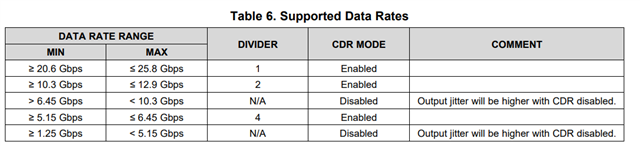

  1. With an RX input of 550 MHz, is it possible for the TX output to reach 5.5 GHz (550 MHz × 10) or 11 GHz (550 MHz × 20)? Is there a limitation that the TX frequency must be within 8× of the RX frequency?
  2. If we use the DS250DF410 (supports up to 25 Gbps with x2 and x4 sub-rate) to design an external 20 Gbps source, does the ATE need to provide at least a 5 Gbps signal (20/4) to the retimer RX?

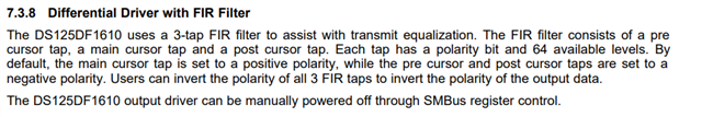

  3. If the retimer can invert PRBS data, is it possible to control PRBS inversion via register settings?
     Ex.
    Normal PRBS7:  1000000100000110000101000111100100010110011101010011111010000111000100100110110101101111011000110100101110111001100101010111111
   Inverted PRBS7: 0111111011111001111010111000011011101001100010101100000101111000111011011001001010010000100111001011010001000110011010101000000

    1. We recommend using only div- 2^N for subrates.
    2. Please see the table below for the supported data rates of the DS250DF410.
    3. Yes, it is possible to invert PRBS output via register settings. This can be done through the inverting of sign bits of the FIR taps, and is described in Section 7.3.8 of the device datasheet.

    1. Our original RX setting is 550MHz, if we expect to reach 11GHz TX frequency with a max divider of 8. Does that mean that the RX signal needs a faster data rate?

    1. A Div-16 sub-rate should work. In your case, this would require an input of 11 GHz/16 = 687.5 MHz. Please see the FAQ below for an explanation about enabling the PRBS generator for the device.

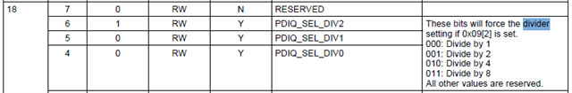

    1. Got it, just to double check, based on the figure below, is the max divider for the DS125DF1610 set to 8?

    1. For the div-16 input clock, the divider is not configured this way and relies on the 0x2F preset. Therefore, the PDIQ_SEL_DIV bits of register 0x18 should not be set. This is demonstrated in the script in the linked FAQ.
