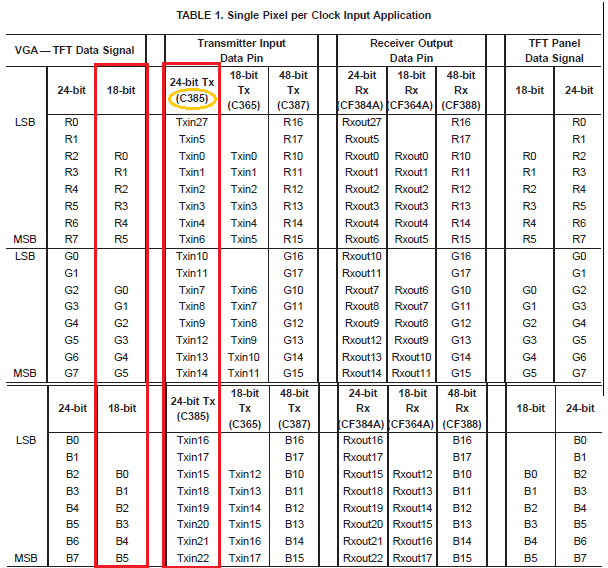

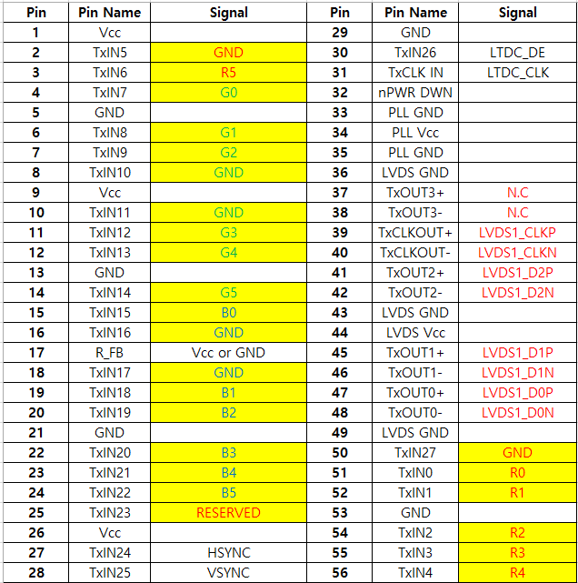

I'm trying to drive an LCD using an RGB666 (16-bit input) source, connecting only TxOUT0 to TxOUT2.
To achieve this, I'd like to inquire about how to connect the pinmap interfaces for the inputs(TxIN0 to TxIN27). [connection order, MSB, LSB connection rules, etc.]
The datasheet doesn't provide any specific connection examples or methods, so I'm wondering how to connect them.
