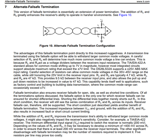

DS26LV32AQML: Inquiry on Selecting Alternate-Failsafe Termination Resistor Values in AN-903
Part Number: DS26LV32AQML
Dear TI Support,
I am reviewing Application Note AN-903 regarding Alternate-Failsafe Termination design.
In the document, resistor values are presented for a 5 V supply. However, I would like to know how to properly select the resistor values when VCC = 3.3 V.
Could you please provide:
  1. The recommended resistor value ranges (RA, RB, RC, RD, RT) for 3.3 V operation.
  2. The calculation formulas or design guidelines used to determine the appropriate resistor values.
This will help me ensure that the receiver input differential voltage (VTH ≥ 200 mV) is satisfied under open/short/fault conditions at 3.3 V supply.
Thank you for your support.
