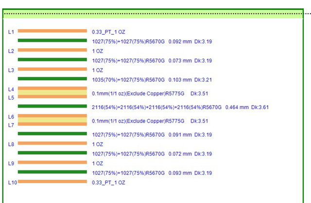

I am using DS320PR1601, for our new project.
I am attaching the stack up our board.
I got the DS320PR1601 EVM board details from TI.
Also we referred its layout and stack up file.
We understood that symmetry is followed in the stack up, while in ours we were not able to follow the symmetry.
Is it necessary to maintain symmetry in stack up?
Also based on the current stack up in order to attain 85ohm impedance, trace width and spacing should be7mils.
But we can achieve only 84.758ohm in top, while in bottom 85.423ohm.
While routing track width of 7mils, we need to have track width difference of 2mil near the Redriver IC.(ie 5mil near IC pin), is that okay?
KIndly provide your valuable suggestions.
