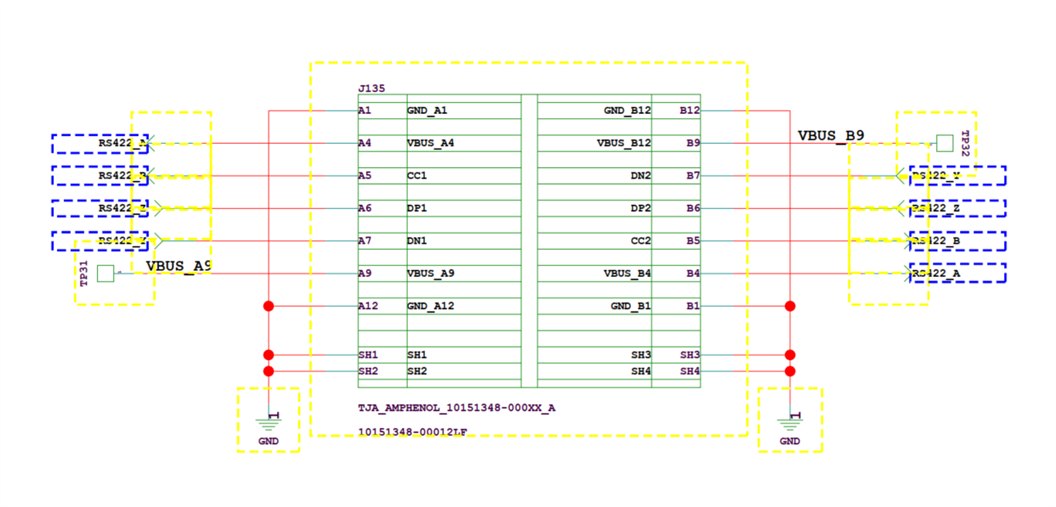

Please review the schematics of  THVD1451DRBR device used in my design for UART to RS422 interfacing. RS422 signals are connect to USB Type-C receptacle connector with specific pinouts decided by me.
Let me know if any termination resistor is required on the RS422 side.

    I don't particularly see any issues with the schematic.
    Generally you want to place termination resistors on the receiver node of the RS422 side which would be the A/B pins. I would recommend placing it to the right of the 10 ohm resistors. Maybe 100 ohms, depends on what your cable's characteristic impedance is.
