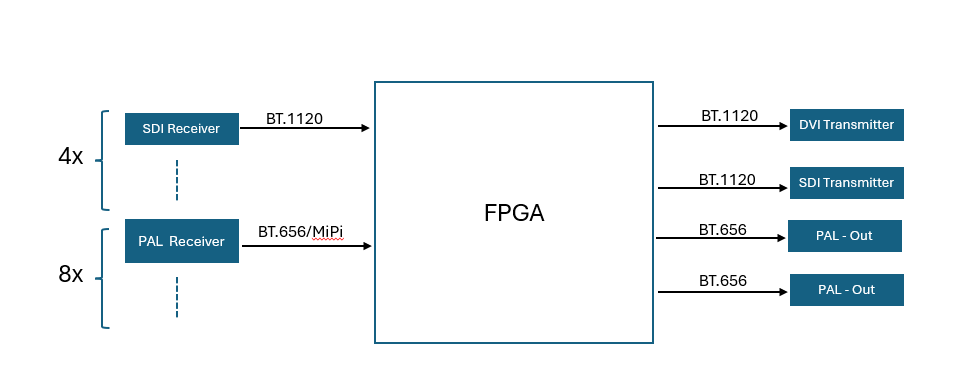

Hi Team,
I am currently working on a requirements for video processing. I am in need of SDI receiver, PAL Receiver, DVI D transmitter and SDI transmitter with the interfaces captured in the below block diagram. Could you please recommend the parts from TI Portfolio which suits my requirements.
Thanks in Advance,
Kiran
  • Hi Kirian,
    What data-rate do you need for the SDI components? IS there anything specific you need the SDI receiver and transmitter to do? (Reclocker, equalizer,...)
    • LMH0318 could be a good part to start with. This has an integrated reclocker on the receiving end and cable driver on the transmitting end. Would this work for the application?
    Our SDI parts will not convert SDI to BT.1120 themselves. Please note this would need to be done by the FPGA.
    Shane
