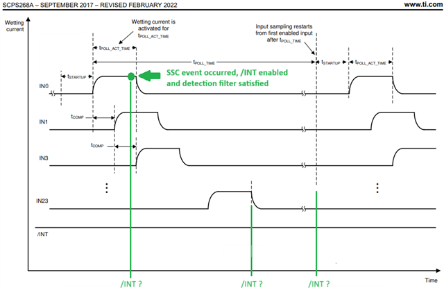

Dear Support Team,
can you please detail when the /INT-pin is raised in polling mode after confirmed SSC:
* immediately when the SSC is detected?
* when all enabled input channels are "scanned" (at the end of the application of the wetting current of e.g. IN23)?
* at the end of the polling cycle?
Please identify in the attached diagram, when the signal at the /INT-pin is raised.
What is the delay from SSC detection to /INT raised?
Andreas
  • Hello Andreas,
    Please read Section 8.3.9.1 in the datasheet since /INT-pin pulled high will be different if you choose Static /INT or Dynamic /INT.
    Josh
  • Hello Josh,
    thanks a lot for your prompt answer.
    Please confirm for Static /INT Assertion Scheme:
    * /INT-pin is asserted in polling mode immediately after confirmed SSC
    * the SSC detection to /INT-pin asserted is without delay after t_COMP
    * independent of the channel number
    * independent of the global timing (t_POLL_ACT_TIME. t_POLL_TIME)
    Thanks in advance.
    Andreas

  • Hello Andreas,
    The /INT pin is released on the rising edge of CS only if a READ command has been issued to read the INT_STAT register while CS is low, otherwise the INT will be kept low indefinitely
    Josh
