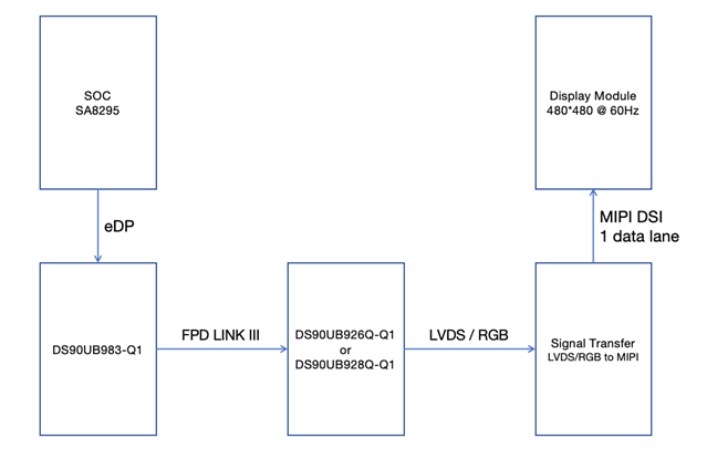

A Qualcomm 8295 platform car product requires the use of TI's FPD LINK chip.
Question:
We want to use the DS90UB928Q-Q1  to use FPD LINK III. However, the current screen resolution of 480 * 480 is not sufficient to meet the requirement of PCLK>25M for FPD LINK III.
If the resolution is increased to a resolution of 584 * 720, it can meet PCLK>25M, but the estimated MIPI rate exceeds 500Mbps and does not meet the requirements of the display module.
I would like to ask if there is any solution to solve this problem.

  • Hi Jack,
    The block diagram is as shown:
    I have to transfer a 584*720 resolution image to ensure that PCLK > 25M.
    The display module support only 1 data lane, so the DSI rata for 584*720 resolution would be 600Mbps (25MHz * 12 / 1 * 2) which could not meet the requirement of the display module.
    Is there a way to use FPD LINK III while keeping the DSI rate below 500Mbps?
  • Hi Tengfei,
    The minimum PCLK supported by the 983 in FPD-Link III mode is 25MHz. This is the only DP serializer so if the serializer cannot be changed then I do not see a solution beyond seeing if there is a display module that can support more than one DSI lane.
    If the serializer could be changed, a potential solution would be using a DP to LVDS converter IC (non-TI part) and using a DS90UB927-Q1 as the serializer.

  • Hi Tengfei,
    Minimum PCLK supported with FPD-Link IV mode is 8MHz so this is a possible solution. The DS90UB988-Q1 is an FPD-Link IV OLDI deserializer. The other FPD-Link IV deserializer is the DS90UB984-Q1 which supports eDP.

    If 983 is used as the DP serializer and DS90UB926-Q1 is used as the deserializer (PCLK ≥ 25MHz), can 926 output RGB565 format data?
    Are there any requirements for the DP signal of SOC or the configuration of 983? Or is it sufficient to only configure 926 as the output format of RGB565?
  • Hi Tengfei,
    What is the reason for FPD LINK III's requirement for PCLK > 25M? Does this requirement apply to all serializers that support FPD LINK III?
    If not all FPD LINK III serializers require PCLK>25M, which serializers would have this requirement?
    For devices that support FPD-Link III operation, the minimum PCLK is not set to 25MHz for all devices. FPD-Link III devices such as the DS90UB925-Q1 and the DS90UB927-Q1 support PCLK operation down to 5MHz. Not all FPD-Link III devices support 5MHz minimum PCLK such as the DS90UB947-Q1.
    As the devices begin to support higher PLL rates it becomes difficult to keep the minimum PLL rate at the same rate as before.
    18-bit RGB and 24-bit RGB are the natively supported video data formats for FPD-Link III mode. If the TCON can only support RGB565, the unused lines from the 926 can be left as no connect.

    ——You mean the SOC could know the lock status of 983 and 926, and could transmit the lock status through I2C via FPD LINK III, and then the lock status could be transmitted to MCU through the I2C interface of 926, right?
    The lock status of the 926 can be read in the 983 by checking the RX_LOCK_DET bit. In the 926, the lock status can be read through 926 register 0x1C[0].
    Jack
  • Hi Jack,
    The display in your system wouldn't be able to display properly with 1024 Hactive. The 983 PATGEN can output with lower Hactive but it cannot be the colors bars or horizontally scaled patterns. You could still do the solid color patterns and the vertically scaled patterns.
    ——You mean that the 983 PATGEN could output about 584*720 resolution image or patterns? And I think the horizontally scaled patterns are quite similar to the vertical scaled patterns( It appears that only the display orientation of the image has been rotated by 90° ), would there be any impact on the verification testing?
    Thanks.
  • Hi Tengfei,
    The 983 PATGEN can output 584*720 resolution patterns. Examples of the vertically scaled black to blue and black to white patterns are shown below. Note that these patterns are done at 1920*1080 for this display in the photos below.
  • Hi Jack,

  • Hi Tengfei,
    I'll follow up with you over email. I will close out this thread for now.
    Jack
  • Hi Jack,
    I adjusted the timing parameters, please check if there are any issues.
    And the resolution would be 516*804.
    Since the DPTX fot the 983 is output by the SoC, what timing requirements do I need to specify for the SoC? Are they the same as the ones mentioned above?
    Thanks!
  • Hi Tengfei,
    The SoC will need to be programmed for the same video timing as the display. I calculated the correct number of lines for the vertical timings. I did not calculate the expected HFP with a given time of 4530.37ns. For a HFP of 300 pixels, this should be 12µs.
    One quick note: Display timings are stated using the Horizontal *  Vertical format. Be careful using Vertical * Horizontal as this may confuse others.
    Jack
