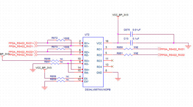

i done the design like this for DS34LV86TMX/NOPB part so could you confirm is it ok .
  • U72 DS34LV86
    Checked Status (Good, Bad, Okay, ?) Additional comments
    Schematic pinout matches datasheet pinout Good
    Local decoupling on Vcc Good
    All input pins are biased Good
    Differential input pins are terminated Good
    Net names correlate between input and output channels Good
    Everything looks good to me.
    -Bobby
