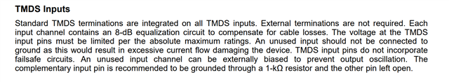

  • Tomohiro-san
    An unused input channel can be externally biased to prevent output oscillation. The complementary input pin is recommended to be grounded through a 1-kΩ resistor and the other pin left open. If they do this, then are you still seeing degraded CH1 input waveform at the HDMI output?
    David

  • Tomohiro-san
    The I2C driver at sink side, SCL_SINK and SDA_SINK, are enabled by setting I2CEN high. When I2CEN is low, the I2C driver can not forward a low state to the I2C bus connected at the sink port. The I2C driver of each source port, SCL and SDA, is also controlled by its 5V_PWR signal. A valid 5-V signal appearing at the input of 5V_PWR enables the I2C driver of the source port. So in the table, with 5V_PWR1 being low, the I2C driver of the source is disabled and Y/Z is High-Z.
    Can they add the 1Mohm resistor to GND on the complementary input pin? The 1M is a weak resistor so the impact to HDMI signal is minimal.
    David

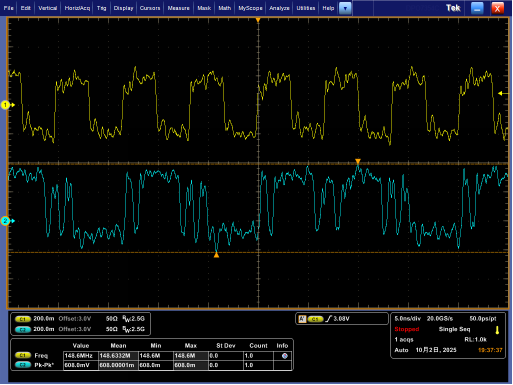

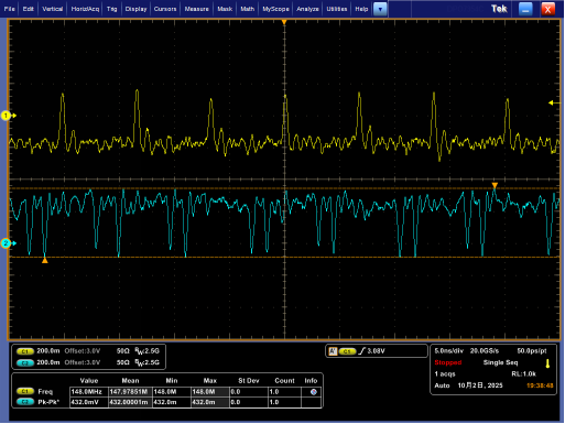

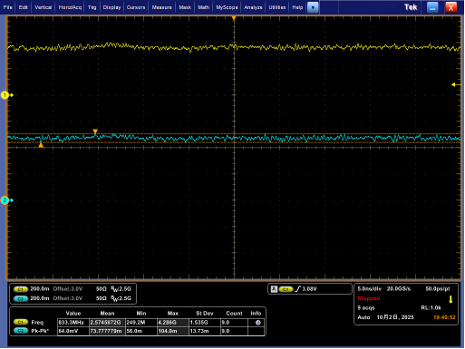

    (Since the datasheet states both are high impedance, I assumed they would behave identically.)
    I will post the relevant waveforms below.
     Wave 1(Normal output): HDMI input = ON, I2C_EN = Low, 5V_PWR = High, _OE = Low
        Ch1 = HDMI_TMDS_CLK_P
        Ch2 = HDMI_TMDS_D2_P
     Wave 2(Leakage output): HDMI input = OFF, I2C_EN = Low, 5V_PWR = Low, _OE = Low
     Wave 3(Output stop): HDMI input = OFF, I2C_EN = Low, 5V_PWR = Low, _OE = High

    Under this condition, Wave 2(Leakage output): HDMI input = OFF, I2C_EN = Low, 5V_PWR = Low, _OE = Low, if you put a 1k or 1M pulldown on the negative of the input channel, do you still see the leaded waveform?
    David
