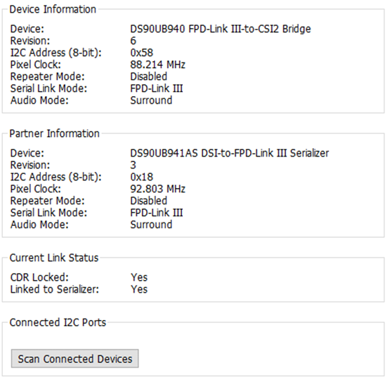

My customer try to measure margin of DS90UB941AS-Q1 in their own PCB using ALP program.
First they used USB2ANY to coonect their PCB to PC.
And they checked that DS90UB941AS-Q1 is detected well in ALP program, and select deserializer, and did margin test.

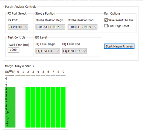

They used the cable below. 1m and 2m cable are reached same results.

  • Hi Chase,
    Just a small discrepancy with your block diagram, the USB2ANY should be attached to the 940 to run MAP, which looking at the screenshot, it is, so that's fine.
    Based on the procedure, it seems like they're doing it correctly. Are they following the steps here -
     MAP.pdf
    MAP tests the entire link between the SER and DES, so it looks like they have good margin for the tested strobe and EQ margin.
    In normal operation though, the EQ level and strobe position are set automatically as part of the Adaptive Equalization (AEQ) process.
    1m, 2m cables are pretty short, so if they are new cables, and their layout between the SER and DES is good, then I would expect passing results for most strobe and EQ margin. If you want to be extra confident though, you can raise the dwell time to give more time for each combination of EQ/SP.

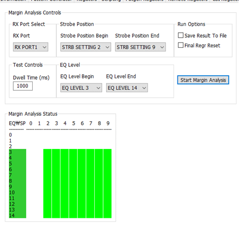

    My customer did more test using their own cable which soldered 2 different cables to make longer.
    And they got a result as below.
    Do you think it is acceptable result?

  • Hi Chase,
    This is fine. We recommend having a a margin of 3 passing EQ levels and 4 strobe positions, including a contiguous rectangle of passing states that measures two EQ levels by four strobe positions, and in both cable lengths, this is observed.
