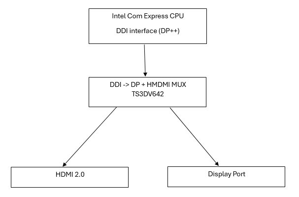

Is there any application circuit available to show, how to connect TS3DV642 in order to drive 2 diffetent interfaces?
Sorce: DP++(DDI of Intel CPU module)
Monitor1: HDMI
Monitor2: Diplayport

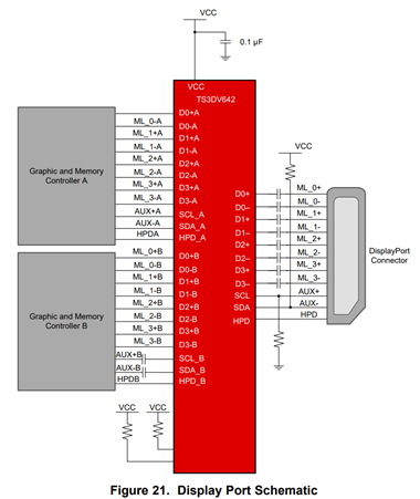

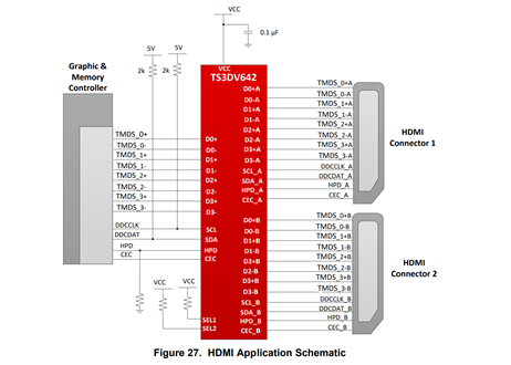

Hi Peter,
Here is a schematic for that shows similar to what you are requesting, these are from the data sheet:
you would just need to configure on of these to be Display:
Similar to this:
